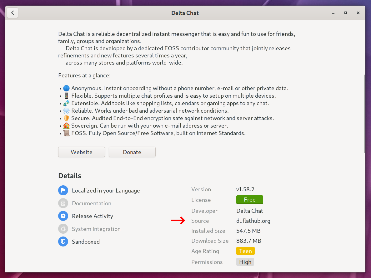

Once you have found an application you want to install, you can review the description, software license and other details on its information page.
Viewing an application's information
You may then choose to install the application by pressing the Install button, or press the back button at the top-left of the screen to return to the search results.

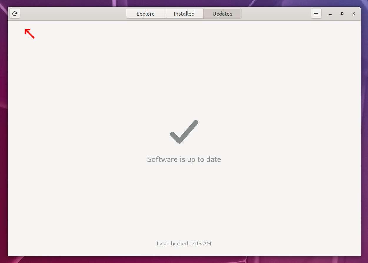

  1. Start Software and click the reload button in upper left corner:
    GNOME Software update refresh list button
  2. Wait for the upgrades to download:
    GNOME Software update download
  3. Click the Restart & Install button once you are ready to install the updates:
    GNOME Software update restart and install button
