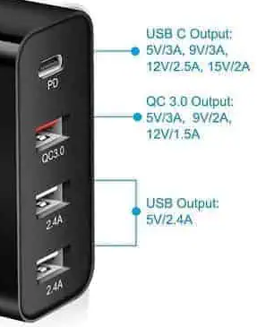

The Librem 11 ships with a 48 W power adapter. 30W device charging is only supported on the top USB Type C PD port:
PD-48W power adapter

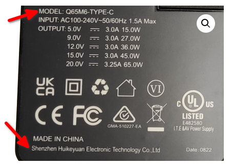

Some Librem 5 power adapters, but not all, can charge the Librem 11, depending on its ability to output 12.0 V. One good alternative is the Shenzhen Huikeyuan Electronic Technology Co., Ltd model Q65M6-TYPE-C:
Shenzhen Huikeyuan Electronic Technology Co., Ltd model Q65M6-TYPE-C power adapter
